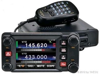

Made the decision that the Yaesu FTM 400 XDR will be the best all-round solution for the rig...pulled the trigger today. Do any of you who have this radio (APRS/2m/70cm) have a favorite antenna to consider mounting on the the truck rack?
Still going after the IC-705 for HF and campsite contacts but after the general license is in hand.
