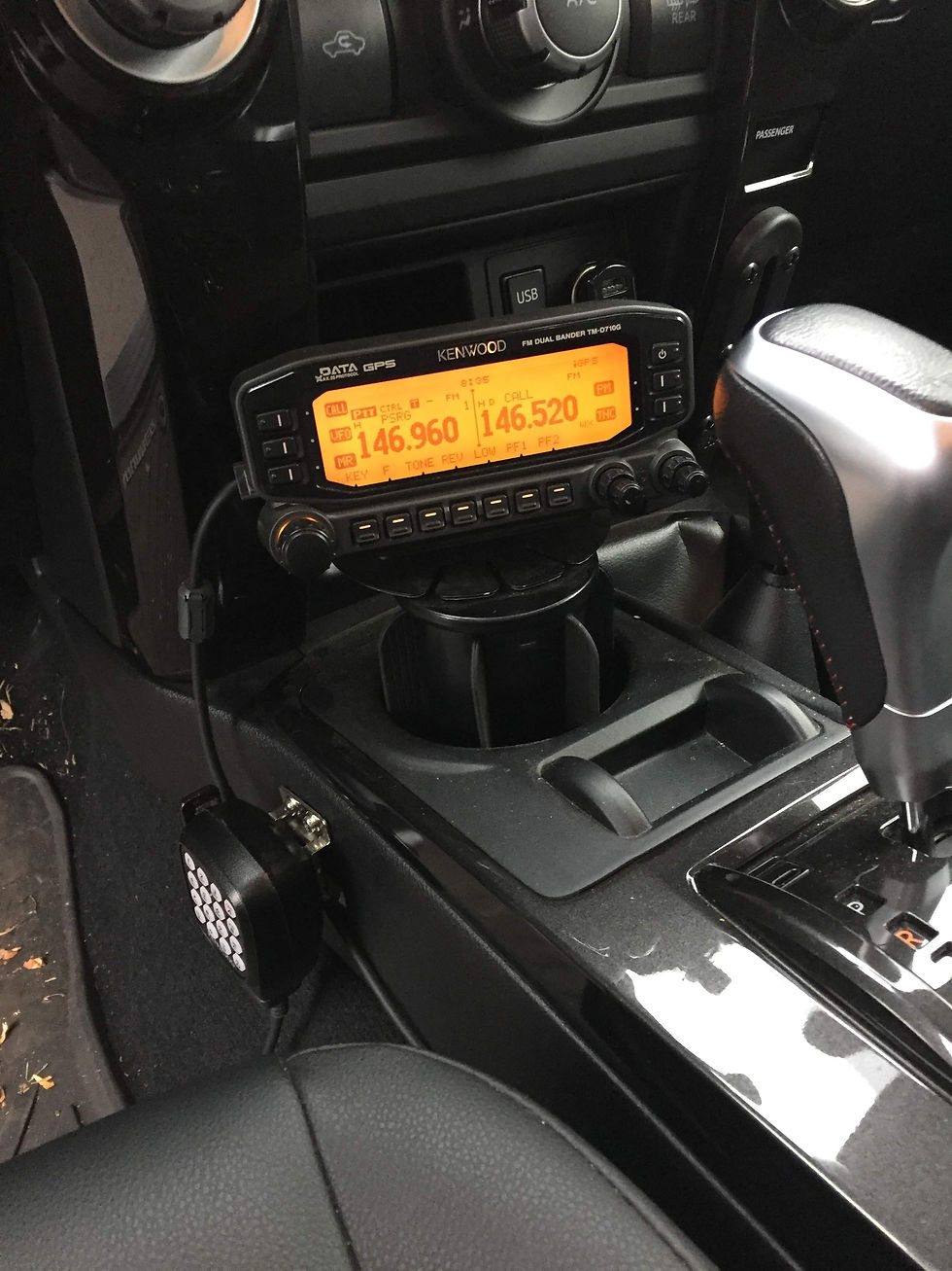

This is how my 710 is mounted. I used a RAM cupholder mount and the dash mount that comes with the radio. It was supposed to be temporary until I came up with my "real" solution, but after a year it's still working for me. I really like my mic placement since I try to keep the dash clutter free and limit cords and such. It's also easy to remove the head unit - keeping "smash and grab" temptation to a minimum.
