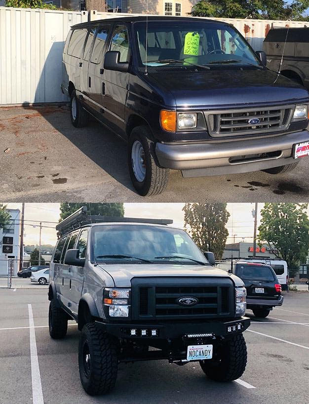

I just joined the group a few nights ago, so, hello! I installed a lift in the rear of my 05' Expedition this week. Hopefully tires are in the near future. Here's a before/after picture.
