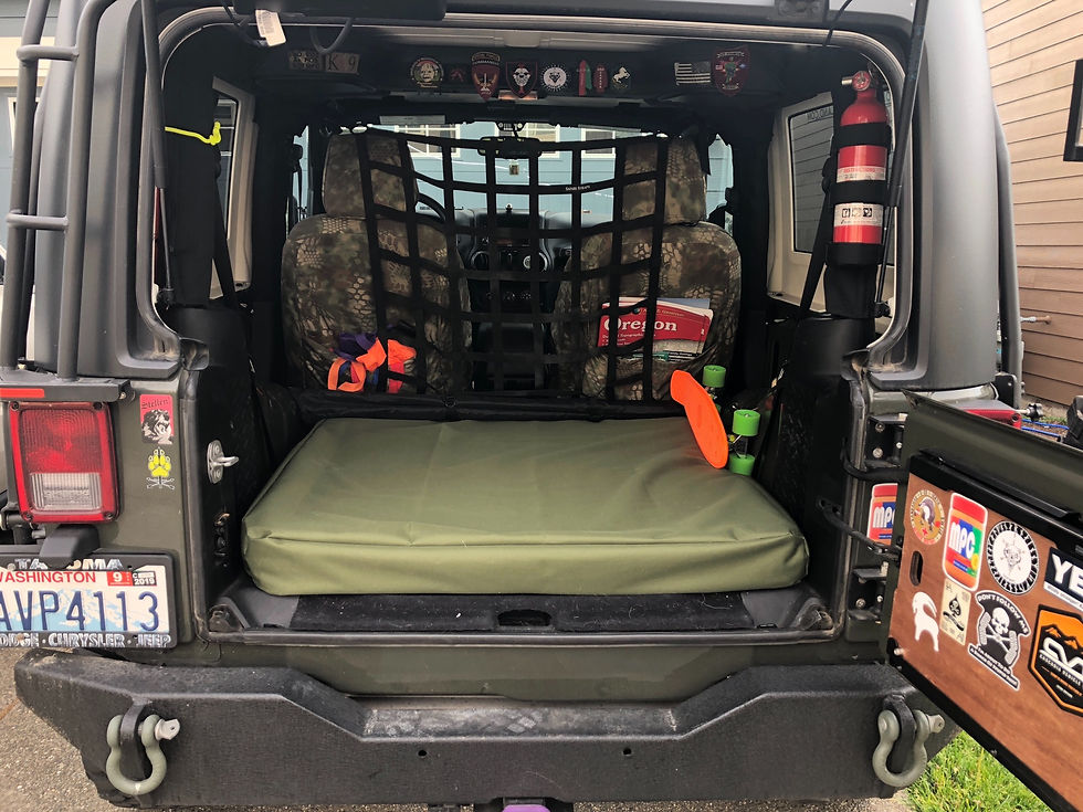

All six of my doggos would fit in there!
Custom fit and covered rear-seatless 2dr JK dog bed courtesy of Pimp My Ride, Arts and Crafts edition.
