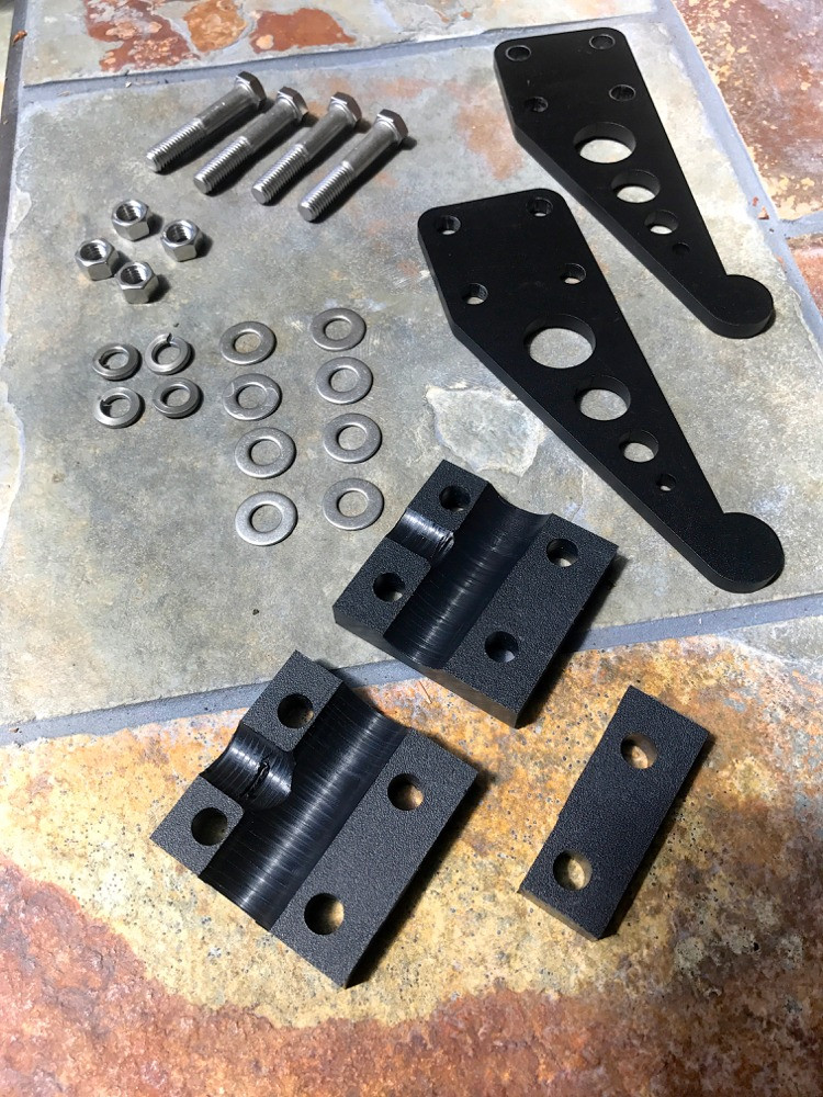

Here's a photo of the mounts I made for my Jame Baroud tent and Gobi crossbars. These help space the tent above the rack so it doesn't rattle by hitting the rack. They also make the mounting more secure on the round crossbars. The thicker stuff doesn't come in black....bummer.
